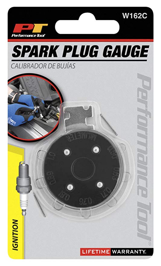

Be very careful gapping them. Do not use a coin type gapper, as it will scrape the iridium plating off of the fine wire tip. Use a common lever type gapping tool with wire feeler gauges available at any auto parts store. Be sure it goes down small enough.
Like this one, which is in millimeters on one side and inches on the other:
https://images-na.ssl-images-amazon....aL._SY879_.jpg
To narrow the gap, tap the ground strap on a block of wood. To open the gap use the tool extension on the side to grip the strap like a lever and gently bend it outward. Do not get it close to the center insulator.
