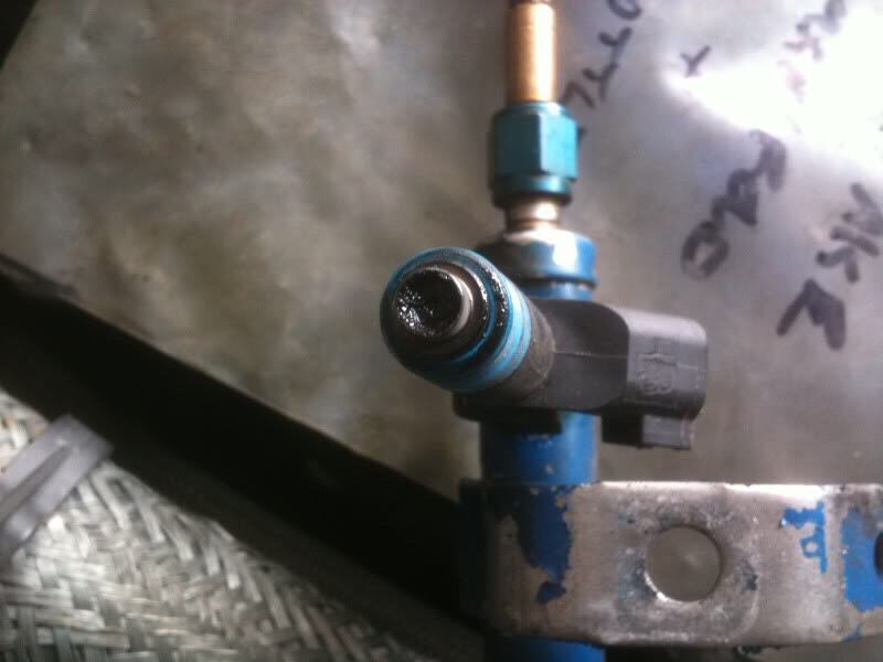

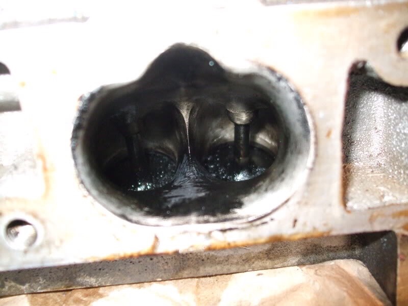

I've been running different mixes of ethanol for a little over 3 years, and here are my experiences with it:
I had the black gummy crap on my injectors a few times after 500 miles when I filled up with E50 or higher at shady gas stations. My hypothesis is that these gas stations, when they switched over to Ethanol, used secondhand gas/diesel tanks to fill up the ethanol with so they could maximize on the subsidy that the government was handing out for the Ethanol Initiative. I cleaned up my injectors by removing the crud with a toothpick and soaking them overnight in carb cleaner. Shade Tree Gas Stations had the most mediocre blends. Once, I filled up with E85 and got E57. Never went back to that place. EVER.
However, whenever I went to a busy gas station on the side of the interstate, like Speedway or Shell, I didn't have any problems of any kind. Because they were moving the product, my hypothesis was that phase separation was kept to a minimum since it wasn't allowed to sit for very long. Fresh Ethanol kept coming along. Also, the highway ethanol gas stations had the most consistent blends.
Also, whenever I visited a local Thorton's, which was a gas station with a brand new tank, I would receive the sticky clear goo after 1200 miles. My hypothesis for this is that the gas portion was secretly being mixed with really low octane fuel without additives. To combat it, I added some seafoam to the car every 5th fill up, and the clear goo never came back.
When I did my testing, I used test strips in the beginning, but then I switched over to a Zeitronix Ethanol Content Analyzer to make life easy.
For all of you claiming they are mixing such and such with such and such, how are you verifying your percentages? I can tell you, firsthand, that Ethanol pump percentages vary like a woman on her period.
Also, if you're looking for a good oil which works well with high concentrations of ethanol, try Mobil 1 Full Synethic 5w-40 for Turbo Diesel Trucks. The ethanol didn't cause this oil to separate nowhere near as bad as it did when I used Rotella T6 5w-40 or other oils. The 5w40 TDT has a lot of extra detergents\additives to help make sure that the oil remains stable in the presence of ethanol. Also, a quality baffled catch will really help your oil quality!
We don't have problems with our injectors getting gummed up. It's a fuel pump problem. I get my fuel from a brand new station that did not get dumped into an old diesel tank. I still experienced black and sticky death in my pump.

I understand that it's not in the same location, but I posted to try to help spark some newer creative ideas and solutions which are specific to this platform. TDI guys have this problem as well, and their solution is to switch tunes and to run on 93 for 3 weeks every 3rd month. Neons also have problems with Ethanol chewing up our fuel level senders as well as clogged fuel pump filter socks with nastiness in them. We don't have a "real" solution for it.
I am from the DIY (If you wanna go fast, build your shit from scratch) First Gen (95-99) Neon platform. We don't have vendors nowhere near in abundance as you guys, so we do a lot of searching from other platforms to find solutions to our problems. I only posted in hopes that the information would trigger a few light bulbs to go off and think of a solution from a different angle.
Again, I also had the black crap from a new tank at a new gas station. My hypothesis was that the owner was being cheap and not adding way below the minimum amount of additives to the 15/20 percent ethanol mix. Half a bottle of Seafoam every 5th fill up cleaned it up. Maybe you guys need some seafoam every 3rd fill up. Your Mileage May Vary.

That port is from an 01 PT Cruiser head with SRT4 Injectors rated at 55lb/577cc's. Only Honda motor I have is a lawn mower.
