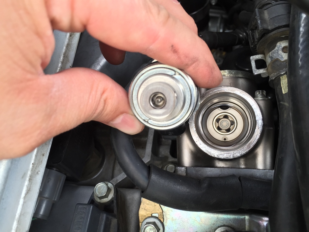

Posted this in the other thread, but figured it's relevant here also, so just copy/pasting.
So just an update, decided to pull the spill valve (no problems, just curious) to see what it looks like. Now this is after ~4k miles on e, ~2k miles on 50/50, ~500 miles on 93, ~500 miles on 50/50, and ~100 miles so far on e (currently running full corn)
A very light "dusting" on the spill valve, that wiped right off as soon as I touched it, and that was it. Everything looks excellent.

I do have a couple of stock internals lying around. Also, since relocating my battery to the trunk, I could probably pull the pump, switch everything, and put it back in about 30 minutes.
If there was a decently cool day coming up, I would do this. But fuck getting stuck on the road in Florida heat right now.
