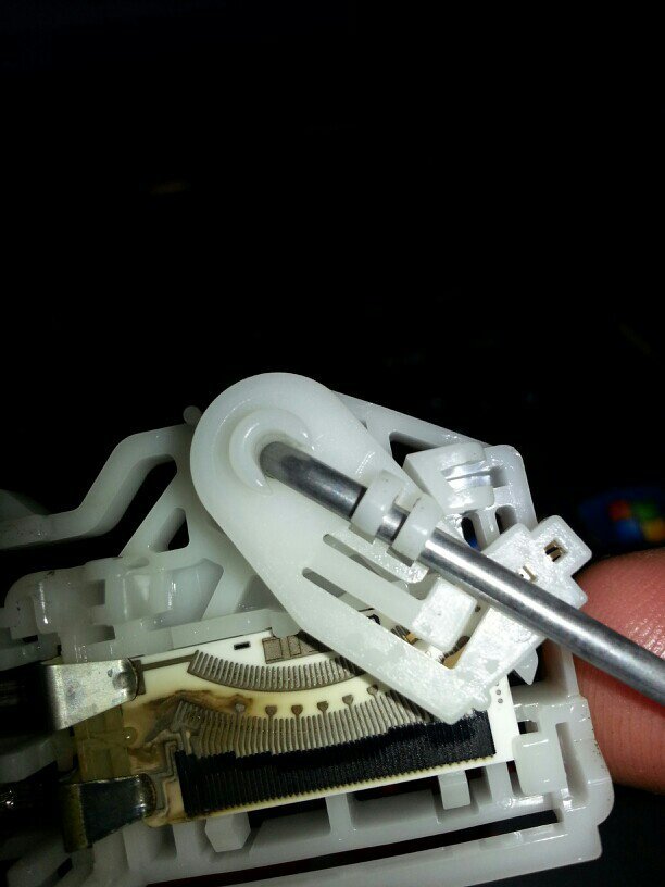

Fuel level sensor told me to get fucked this morning. Just filled up and the gauge had no fuel bars on it, and the light was on. The I started driving and with the more miles/bumps I hit, the more fuel I got back. By the end of my 50+ mile trip, it was reading correctly again, but who knows how long that will last.

Where my wires connect to the actual sensor was corroded as if it were sitting in a salt bath. I wish I would have taken a picture.
I believe a Juan's gauge is analog.... Maybe why we dont here it happening on them as much.

How did everything else look when you pulled it?

I switched out the pump aswell so I had the entire thing taken apart. Nothing else looked affected except for the one spot I refereed to. I know Honda guys use a marine sealent to cover the sensor and it seems to work fine. If mine goes bad again I will definetly be doing it.
We have an access hole but its to small and needs to be cut bigger to allow the basket to be pulled out. The one up we have on Juan's is that we require no special tools to remove the cover, just a screwdriver.

They've ordered me a new sensor, just waiting for that to come in, and then hopefully I'll have my car back.

I believe it was cheap. Fro, from VA said it was like $30-40 bucks for the part, and about an hour or so to do.

No demoding done, but that is my dealer. They just drop the tank, they did have to drop the exhaust (from the axle-back).
I think that my mods wont affect that sensor (wont tell them about the E) so I might give it a try without demoding. . My dealer is also pretty understanding, Will start to look for a meth kit to do meth instead of E....
Sent from my SPH-L900 using Tapatalk 4
Definitely take E85 out of the tank and change the tune back to a 93 map, maybe even one with low timing. This way if they take the fuel out to do the FL sensor, you don't have to worry about the wrong mix being put back in, or running aggressive timing with mixed fuels, like 87 octane.
He sent me a text today saying they want me to come pick it up and bring it back when it has less fuel in it. So I'll have to switch back to a 93 map for convenience. I had filled up when it decided to take a shit. I'll probably take it back to them next weekend.
Thanks I'm running my 93 map since yesterday and I already miss my extra HP, i will run a few more tanks of 93 before i take it in, just in case

Just refilled with 93 and everything is back to normal, full bars of fuel, even the range got fixed, (it was stuck on 80 miles)... so far so good =)

Yeah car seems to run fine, and gauge is working for the moment. Still going to get it replaced, but not immediately.

While i was on 93 everything was fine, went ot my 2Gl map and everything was fine. then flashed my 4Gl map and after half a tank everything was screwed... Soooo i have an appointment saturday to get checked... but i already found another thread with help. here it is if needed: Those with bad fuel level sensors
TL;DR, My sensor is screwed, need to replace this part if im not cover under warranty BBN660960.. less than 50 bucks

And the new one failed in less than 2 months. lol
We need a solution.

93 octane... I have been on 93 since the new one only use the 85 for events and weekends
We need a solution.
Did you grease it?

grease in the fuel tank?

Originally Posted by Dimenus View Post
Did you grease it?
No. Remove and install.
And fuck watching for knock and having less power. We need a solution, not regress back to 93.
