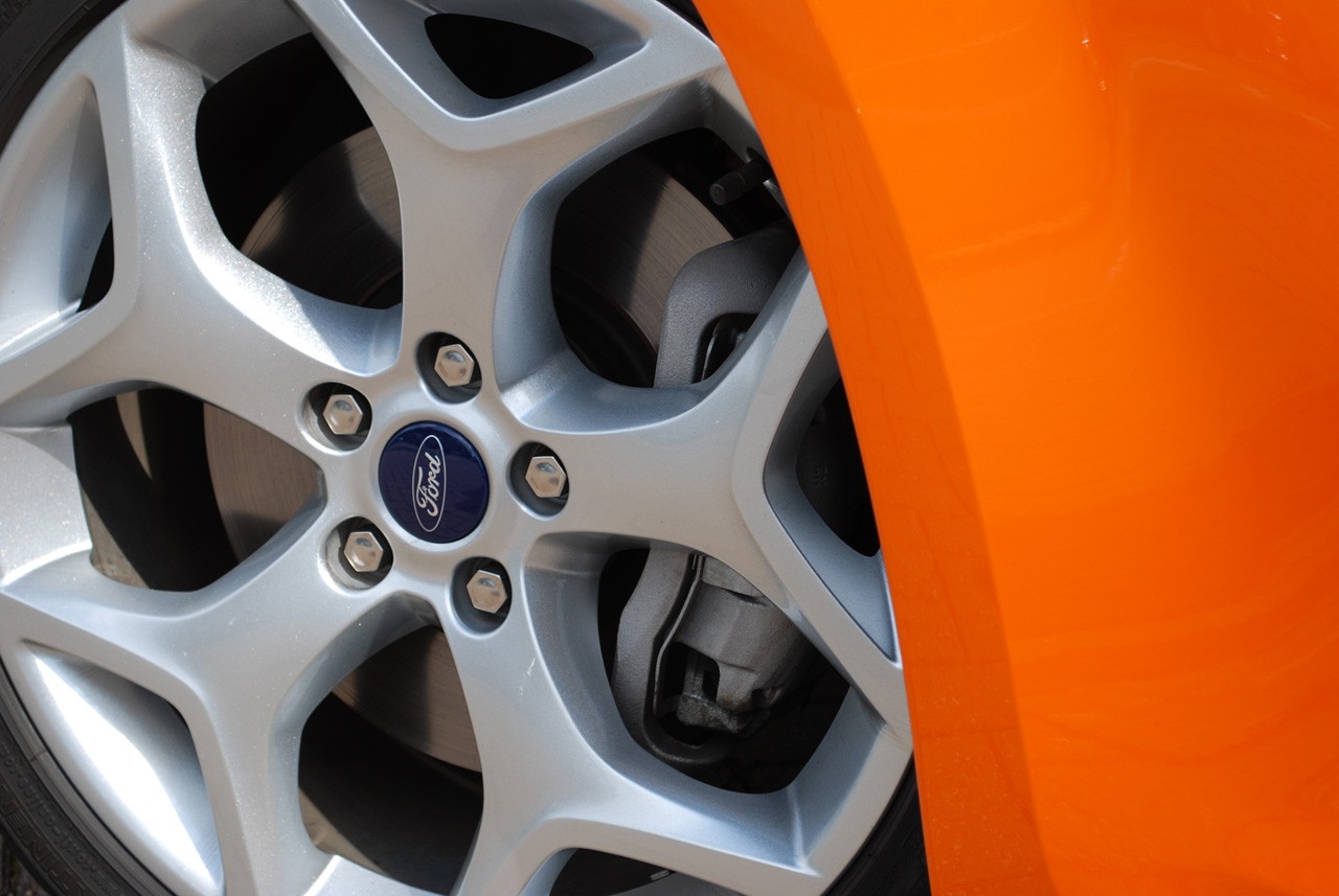

The turbo awd version of the S40 100% uses the same caliper as the MS3. I have seen the cars side-by-side and they are identical. The other versions of the S40 use the same front caliper as the regular Mazda 3.
This one has the MS3 caliper.
And here is another application, the 09 Euro Focus ST:
Boother is offline
