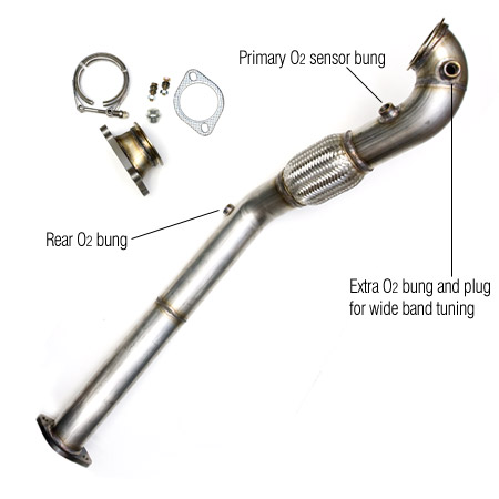

Things you NEED to know: Downpipes for Mazdaspeed vehicles are manufactured in two different styles. The first style is generally referred to as just a "3inch downpipe", these units will replace your original downpipe and ONLY the original piece (these are generally coupled to a "race pipe" or "test pipe" *SEE DIAGRAM ABOVE*which removes your secondary catalytic converter). The other style is known as a "Long downpipe" or "Full downpipe", meaning the new part will replace BOTH your stock downpipe and also your stock "race/test pipe".
Downpipes are generally sold with two options. They are referred to as either being cat-less or as having a high flow cat (the term cat refers to a catalytic converter). A cat-less downpipe is exactly what it sounds like, it replaces your OEM piece with a new 3" downpipe possessing NO catalytic converters. One possessing a High Flow Cat, also, is exactly what it sounds like, it replaces your stock restrictive cat for a more efficient, higher flowing unit. Generally, cat-less downpipes provide a few more peak ponies and a more aggressive exhaust notes than pieces with a high flow cat, BUT at the risk of the car receiving a CEL (Check Engine Light). Note: If a downpipe contains a high flow cat it is generally a "Long/Full downpipe".

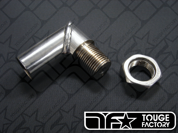

However, there are ways to help prevent this CEL by extending your rear/second o2 sensor away from the main flow of exhaust through the downpipe. Some manufacturers include these fixes with their products, while others do not.
Commonly spark plug de-foulers are used. The first is left alone and the second is drilled out to 1/2", seen here:
Companies also offer o2 extenders taking away the drilling work for you, seen here:

The DP is the most restrictive section of your exhaust system. The bell housing is so crimped; it is hard to imagine the waste-gate having enough room to open. It contains cat-1, which is heavy, but not as heavy as cat-2. If required for emissions control, if you do not have the software to cancel the CEL (in AP un-tick codes: P0038 and P0420 (if rear spark plug de-fouler does not work)) or if you are allowed to disable two codes only for emissions testing, you will need a fast cat with following oxygen sensor bung for the second sensor. A DP provides faster turbo response times and power gains across the rev range. The transition from decelerating to accelerating is much smoother. The engine just seems to breathe easier, probably due to the increased VE.
Divorce pipes reduce the turbulence caused by the opening and closing of the waste-gate. Also, the nature of bell housing designs creates turbulence as the chamber is expanded to cater for the turbo outlet and waste-gate. Having dedicated pipes respectively allows for same size pipes and thus, a smoother flow. By joining further down, they help to speed up the extraction resulting in faster opening of the waste-gate.
