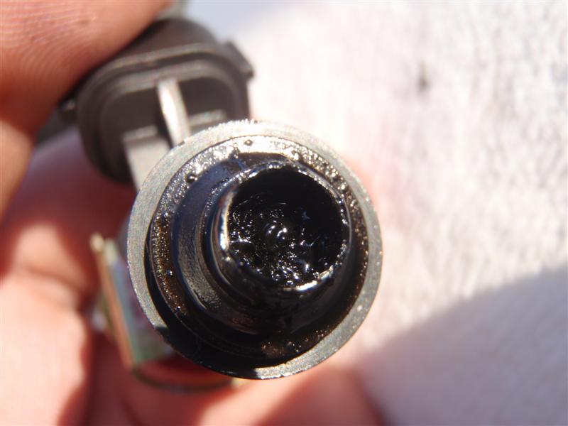

Here is the EvoE thread on injector gunk after running E-85:
Injector Gunk after 2 months of E85 - Evo Empire Forum
Here is one from EvoM on injector gunk after running E-85:
3 tanks of E85 and look at my ID2000's! unreal! - evolutionm.net

I am not convinced that is gunk from the tank. It is more likely a reaction E85 is having with vapors or fluids in the vehicle. Almost looks like oil sludge.

John, thanks for the info. The second link is a great read.

I had a very similar experience as you when I did some testing on 100% E-85.
I have tuned many cars running E-85 (Subaru's, EVO's, GTR's) but all being port injected and the results of tuning with E-85 were so nice that I was determined to run it in my MS3 no mater what It took. So I started by getting my fuel level as low as I could and then filling up with E-85. From my past experience with E-85 I knew I would need approximately 30% more fuel so I added 30% to my MAF curve to get the extra fuel and flashed the map.
All was well for about 20mi and then bam fuel pressure dropped to about 60psi and anything more than about 10% throttle and the car would fall on its face. The next day at work I removed my HPFP and found the same black gunk as you. At the time I was running a set of KMD internals and after cleaning off all of the gunk I found lots of wear on them, so much that I was uncomfortable putting them back in, so I put my factory internals back in and put it back together only to find I still had no fuel pressure. Luckily I had a spare pump that I swapped the spill valve from and all was well again. So Before I put the car on the dyno I wanted to at least run one full tank of E-85 to make sure I wouldn't have any more problems with the fuel system.
The next problem I ran in to that ended up stopping my testing was the load cap. Since I had raised my MAF curve by 30%, I was hitting the load cap at very low boost levels. At the time we hadn't uncovered the load cap so my testing on E-85 was put to a stop.
Now on to the good part. Before I had run a full tank of 93 I had a injector fail, it stuck open at WOT, full boost, and 5000rpm and the end result was a bent rod due to that cylinder hydro-locking with fuel.
So I am glad to see that more and more people are starting to venture in to the E-85 world, but I wanted to share my experience so that you would know what possible failures you could run in to.

Did the motor run after you ran the E85? If so, chances are that "gunk" was also coating your injectors and perhaps caused it to stick open.

Alright guys, I've learned some things today. Another theory for the black gunk is electrolysis. When I was searching for fuel filter options, I came across this thread on a mustang forum: Fuel Filter E85? - Page 2 - SVTPerformance
The above thread is great for two reasons: The electrolysis theory, and that I might just need to ground out the pump body to rid the system of any excess voltage. And the second reason: the fuel filter that is highlighted in the thread is a stock ford part, with seemingly identical hose barbs that we find in our cars. The guy was running it with straight E85 with no ill effect. Here's a picture of one of the filters:
What I think this means is that I can purchase another one of the intermediate soft lines that goes from the firewall to the CDFP, and mount the filter somewhere in that region. I called one of my Mustang crazy friends, and he says the stock 03-04 cobra filters are supporting over 400whp and 100psi of fuel pressure with a kenne bell boost-a-pump. A viable option, right now, and one that I can put in place this week.

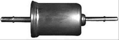

We have a winner for the fuel filter:
The hose barbs are almost identical, just about 1/8" shorter on the cobra filter. I'll order the line tomorrow, from Mazda Motorsports. In the meantime, I'll have to figure out where to mount the filter. It's a little bigger than I expected, but I think I can tuck it right next to the firewall between the battery box and a heat shield down there.
While I was out messing with this in my garage, I went ahead and wired a direct ground from the CDFP's bottom bolt to the negative terminal on the battery. Once the filter is in, we'll be able to pinpoint the issue even further. I pulled the CDFP and cleaned the spill valve and pump internals, so we can see any change. The internals were pulled ~200 miles ago the last time, and they didn't look as bad this time around. I'm still hopeful about this working out.
I poured the ethanol/oil mix into a glass jar while I was out. It is milky, not anything like what we saw on the internals. When I pulled the sample, it looked clear and nothing settled out after leaving it for a few hours. BUT, that does not mean it doesn't contain anything. I'll let this mixture sit, just in case it does precipitate.
