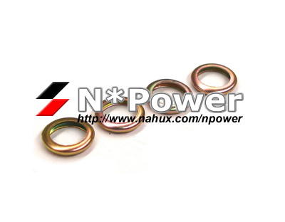

WASHER 2.5M NOZZ SEAT x 10 | Darwen Diesels Ltd | Common Rail Diesel Spare Parts
"Exclusivity" - CP-enis
Demodded.
The Seals

So this is a washer style solution?

According to the Toyota illustration that I have it just looks like a rubber o-ring but it may be wrong. I had the dealer fax me a copy of it so I could look at it before I received them.

Hmm, interesting. I do see a short lifespan on these seals if they are made of rubber/teflon. VW and Audi use a very similar seal but the injector has a step inside of it for it to seal to seat on.

They look brass to me

I looks like it has a "Seat" that might be brass so do you think they would pair two brass seals/o-rings together? Not sarcasm that's a real question.
