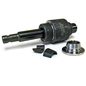

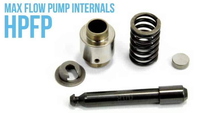

CorkSport Max Flow Fuel Pump
part number Gen-6-999-10 $349.99
CorkSport Max Flow HPFP Fuel Pump Internals

Most low level flow mods are ok( intake,test pipe, CBE etc)
Add an upgraded intercooler or a tune and your pushing it.
Add a downpipe and you might as well get the internals installed FIRST.
Don't even think about upgrading your turbo without an upgrade.
GEN 2 MS3
The genpu does not play as nice with the HPFP.
Many need an upgrade with just an intake, and Cobb states that some HPFP's will not keep up with stage 1 maps.
Upgrade should be very early on your list.
CX-7
I'm sorry I can't find much info on your car, I will add it later if I get more data.
I cannot say this enough the ONLY way to know for sure is through logging.
OPTIONS
So you've decided to upgrade, now what? Well, you can either buy yourself an upgraded pump, or save some money and buy upgraded pump internals to install into the pump yourself. The full pump is about as easy as it can get to install, but many members here have installed internals themselves with no issues(this is the route most take).
All these items are available from many different vendors both on MSF and not, and at varying prices. I am only linking to the manufacturers site and giving their prices.
You will notice some are listed as VW/AUDI parts, this is because we share a common HPFP with some of their engines- do not worry about that
I will list the internals kits first.
Autotech
part number 10-127-100k $399.95
VW Performance - Autotech Sport Tuning: Hi-Volume Fuel Pump UpGrade Kit 2.0T FSI
KMD
part number 03020 $329.95
Audi - A3 - 2.0T FSI - Engine - KMD Tuning - 2.0T FSI High Pressure Fuel Pump Kit - KMD Tuning & Engineering
HPFPupgrade(ptp)
part number HPFP00005 $349.00
Mazda DISI Do It Yourself Pump Internals | HPFPUpgrade.com
Now for the full pumps
Most pumps will require you to pay a core charge added to the price of the pump, when you install your new pump you send your old pump back to them and get your core charge refunded back to you.
