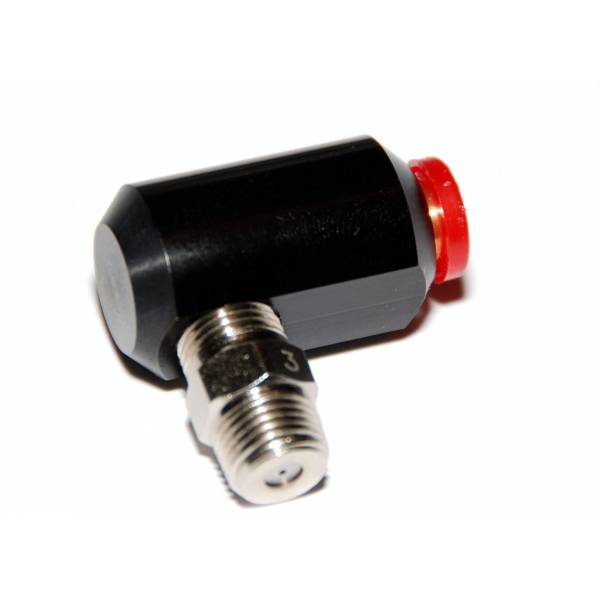

Most kits use either 1/4 tube push to connect or -4AN threaded fittings. -4AN specs shown below.
Can be used as a nozzle holder and is 1/8 npt for both fittings (both sides)
-McMaster-Carr
Nicest of all the push connects I was able to find here:
The nicest water methanol injection nozzles and fittings
http://www.snowperformance.net/82204...eck-valve.html
Can be used to switch from 1/8 npt to -4AN threaded fittings
McMaster-Carr

So, unless I am mistaken, there really isn't a path besides bottom mounted really is there? Front facing side is blocked by throttle plate motor assembly, top side appears blocked by the manifold runner and throttle body and I don't imagine there is much clearance on the back side. Has anyone successfully got them on the top with a combination of fittings/nozzles? Underside wouldn't be my first choice tbh just because I can't keep an eye on the fittings.
I bought a couple of these, I don't even think they'll thread on without extensions. It looks like they will hit the throttle body ears when attempting to thread them on.

I ran this plate for a while with Devils own nozzles. It was very tricky to fit because of the thick holders. I ended up selling the kit to go a different route.
Fast forward a year later, I'm trying meth again with the same plate but snow performance nozzles and holder.
