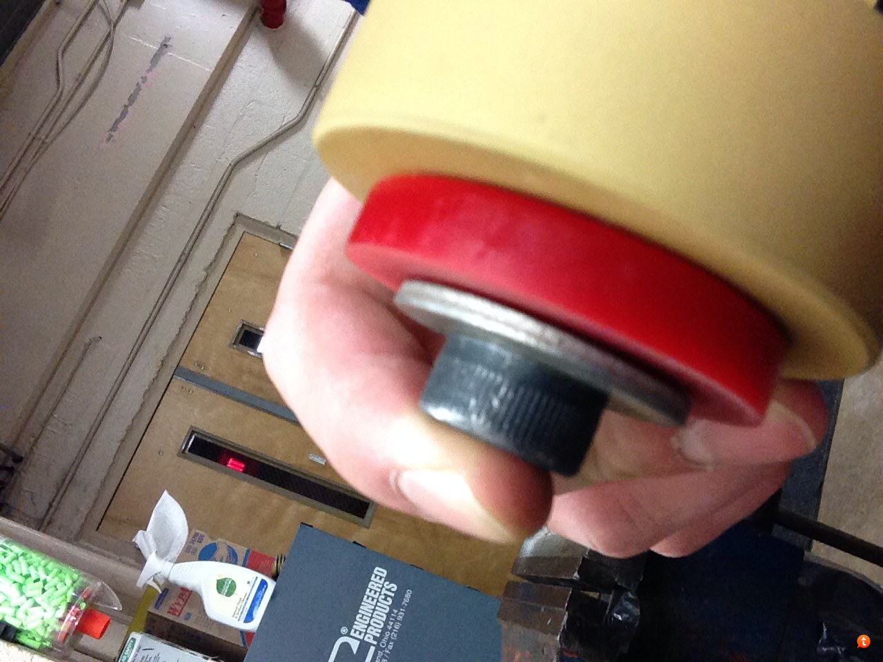

Just to be clear u can use thicker washers then 12mm or 7/16 right? Bc i have some that a little thicker but will still let the nut thread on correctly
 Old 06-03-2014, 06:00 PM   #5
Nano91's Avatar
Posts: 286   (View Stats)
Thanks: 21
Thanked 183 Times in 82 Posts
Yes, just put it in a position where the damond washer is the one making contact with the bushing
Damond washer?
Here is the set i have right now.. Is it okay to stack washers?

Damond washer?
I ment provided
Damond washer?
Yes, I also stacked them except I didn't use locking washer. Should be fine I will check how my nut looks tomorrow make sure all is intact. After my drive it all seemed to be fine.

Should work as long as a few threads are poking out when tightening the bolt

I stacked two 12mm washers on the allen side of the bolt. This allowed the supplied nut and washer to tighten down on the metal sleeves without running into the bolt shoulder. I torqued it to 55 ft-lbs and the clunk is gone!! The bushings hardly look deformed, so very little stress is put on them axially. Unless a better solution is found or the clunk returns, I am leaving this setup alone.

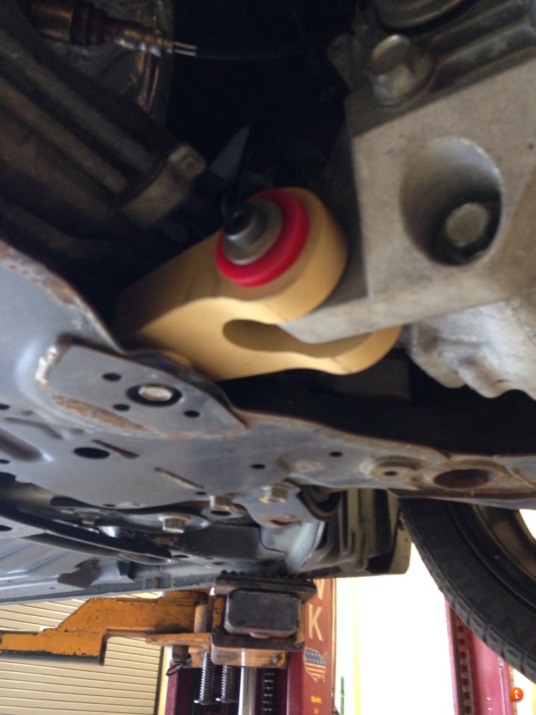

Alright, as promised, review as of today with maybe 20 miles on the new RMM.
A little background... I had originally purchased and installed the JBR 88 and ran that for about 300 miles before going back to the stock w/ CS Inserts. The vibes made it race car worthy but the resonating noise as a result of the vibes was next to umbearable. The CS Inserts were fine, next to no vibes at all but just felt too soft and then I saw DM's RMM and had to have it. I am still running the stock PMM and TMM.
Received the RMM in the mail and first thing I thought was holy crap this thing is heavy. That said its a beautiful piece of engineering, at looks good to although I was concerned to find a shoulder bolt but I held out and had faith. Had the mount sitting on my desk for about 4 days before I got a chance to install it, needless to say I was itching something fierce. Having no instructions I came back to the forum to see if anyone had any tips or pointers on torque requirements and say 40-45tq on the shoulder bolt and I felt much more at ease.
Install went just as any previous RMM installs, with the exception of the shoulder bolt not being able to torque down. Got it as tight as I could and the bolt still easily spun. Reinstalled the bolt about 3 times all with the same result. After closer inspection it appeared approximately 1mm of the shoulder of the bolt was extending out past the end of the bushing and the provided washer did not clear the shoulder but instead while tightening down the should would start to dig in and deform the washer and it was starting to look like LatinKraze's and ear28's. As concerning as this was I recall reading those who had similar issues and resulted in clunking but without any anticipated damage to occur as a result, I decided to stick with it. Clunking was anticipated and clunking I had occasionally during initial acceleration, occasionally around turns while accelerating, and constantly when reversing. This was also accompanied by vibes through the frame, but I had to admit the resonance as noticed with the JBR was not present, so far so good clunking aside. After seeing others using various washers and lock washers to resolve this I decided to start digging and found a couple washers of my own but that would have to wait for tomorrow to fix.
Install Day 2- Before attempting my own washers today I checked in to the thread again and saw that 7/16's washer should do the truth, this is when I found that the washers I was dug up were only 3/8 and wouldn't do any better than the provided one, so ran over to Lowe's and picked up a pack of 7/16's. I lostened the bolts for the mount to allow for movement and to add the new washer to the shoulder bolt. When I removed the supplied washer and nut and placed my own 7/16 washer in place I found that it fit perfectly over the extending part of the shoulder and allowing the provided washer to mount flush. I began tightening everything down and noticed that the 7/16 had slipped off the edge of the soulder and was presenting me with the same situation as with the provided washer, not being able to torque down the nut as needed. 2 attempts later I found that I had to slowly and carefully tighten the nut down to ensure the 7/16 washer remained in place. I was able to get everything torqued down to specifications including the 45tq on the shoulder bolt.
After finishing I took her for a test drive. Vibes definitely still present but clunking completely gone and still no adverse resonance like with the JBR. Wondering if the vibes will settle as the bushings break in, but what I've felt and noticed thus far I would definitely be ok if they don't.

Yup, this is nothing more than a tolerance stackup issue. Washers for this time around ended up being a different size. Like I said, .070" causing this.
Wetz is doing testing on a new setup, but the result was instant and thoroughly successful. Give me a few days to feel all warm and fuzzy, then I'll send out a care package to anyone that wants one with new nut and washers so you don't have to guess.
Pull the bolt, put an additional 12mm, 7/16, or 1/2 in washer under the head, put it all back on invluding the 10mm washer. TORQUE TO 25 ft-lbs. Please do not use hardware that wasn't provided or recommended, especially lock washers or a regular bolt.

Well installed the mount. So far no clunk but i do have more vibs then i did with my old mount but i will give it some time to break in and then see how it feels

I put about 70 miles on the mount after adding the washer to the nut side and no more clunk. Vibes are still more prevalent than before. I'll wait for the proper washer and nut to torque to spec and see if there's a difference. Could just be the bushings breaking in too.

I agree prob is the bushing. I will give it 1000 miles to see if it improves if not back to the old mount lol
