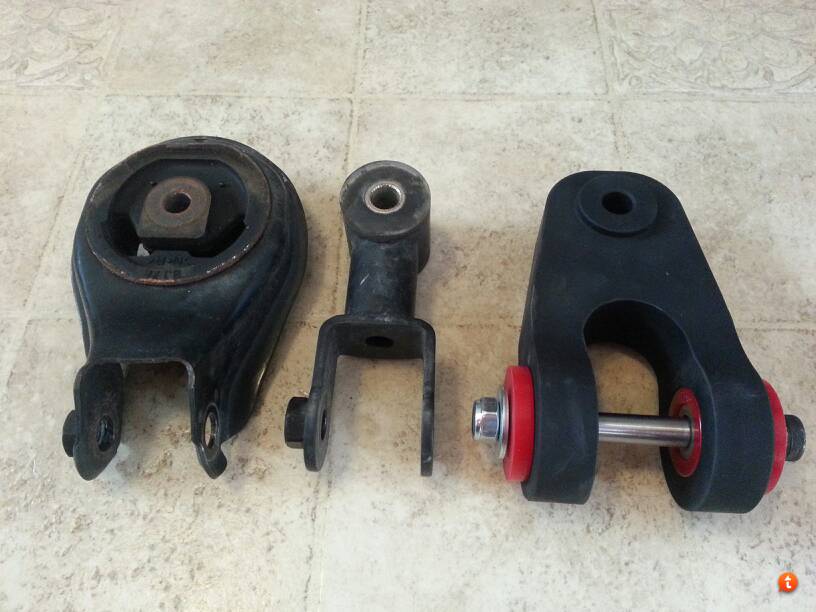

Stock, TRZ dogbone, DM sexiness.
Vibes are WAY down, in car noise is down as well. As said above there are no deceleration vibes (TRZ was BAD).
I do have a new clunk/rattle on startup, I got the car back in the air to check the torque on everything. I can move the hex bolt with a rubber mallet so I wonder if that's the culprit. I'll see if it settles and remove/reinstall if not.

Originally Posted by mdl3v8 View Post
Attachment 161909
I do have a new clunk/rattle on startup, I got the car back in the air to check the torque on everything. I can move the hex bolt with a rubber mallet so I wonder if that's the culprit. I'll see if it settles and remove/reinstall see if not.
Sent from my Samsung GALAXY S III
Hmm, @YoursTruly; had a similar issue I believe. It looked like either the supplied bolt was slightly smaller than needed or the hole in his transmission bracket was larger than normal.

I think the problem I am having is that the hole in the bracket on my transmission is too large. Before anyone asks, the bushing is still in it and so is the metal sleeve. Furthermore, the sleeve has no obvious tool marks, so I don't think the previous owner drilled it out.
I can rock my car forward and back and watch the trans mount slide around in the RMM. This caused massive clunking and insane vibrations. I hope I don't need to buy a new bracket.
I will try to have pics up soon of the size difference. Also, I tried using shim stock to fix it, but it only cut down on the clunking.
Edit: I just checked, a new bracket is 30 bucks. I might buy one just to check it out.

I installed my mount yesterday after reading your post about the bolt being a little small for the transmission bracket. I am coming from an OE mount, and so I played with the stock hardwares a little. For as far as I can tell, the DM mount is spec very close to OE. The stock bolt is also slightly smaller in diameter than the hole in the transmission bracket.
After assembling the motor mount (both DM and OE) to the transmission bracket off the car, both mounts wiggled a little in the transmission bracket. However, after installing this assembly in the car and torquing everything to spec, everything is solid.

Putting a regular hex bolt on that setup will compress the flanges on the bushing. This may eliminate your clunk, but this will reduce the life of the bushing. This is not a solution I'm comfortable with.
This is being actively worked, and I'll keep you guys updated on what is causing the problem, and what the recommended solution is. Everyone with the issue will be provided whatever is needed to address the issue. Just asking for a little patience, please.
Stock bolt and shoulder bolt are both 12mm.

I went out and did the same. The bolt used to spin freely with supplied washer. Now it takes some effort to spin the bolt after replacing the supplied washer.
Pic 1 shows where supplied washer contacted bolt shoulder, Pic 2 is the new washer over supplied washer to show difference in size, Pic 3 shows mount with new washer and lock washer
Test drive soon.

Posts: 825   (View Stats)
Thanks: 481
I don't have the size. I had a bunch of washers I used. I tried using a dremel but it was taking too long. I know it's slightly bigger that 3/8. The washer I used was a little smaller but had a bigger hole. I'm gonna try to get to the hardware store tomorrow, so hopefully I'll have a proper size.

@latinkraze. That looks like the same washer I used. I have the same exact pics.
I don't know where this washer came from either. It's in one of drawers with washers left over from other mods, lol

I had to use the washer from my JBR 88 to get the clunk to go away. I put a couple hundred miles on it today and I'm happy with it. I got increased vibes from the mount which seems to go against what everyone is saying. I have JBR sides and going from the 88 to this mount added vibes. With that being said and aside from having to basically install twice, I love it.

So, test drove again after swapping washers. Vibes reduced even further and the clunk is gone. I am extremely happy with this mount. I'll report back in a few days with further feedback.
